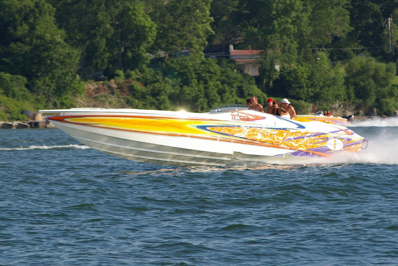

    Also mine did fine in the rough water
    Flew level and re-entered well.
    Attached Thumbnails Attached Thumbnails Jar%20tiger.jpg   Leopa start.jpg   June142008%20%2830%29.jpg
