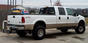

    I wouldn't hesitate to tow with a 6" lift one bit. Definitely go electric/hydraulic brakes though.

    I towed with a 4.5" lift all the time and with the larger tires gave it an effective 6" lift. The hitch I use was called roto-eze by Action Manufacturing but I think that particular company may no longer be in business.
