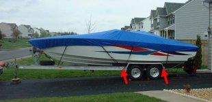

    We melted some lead and bolted it to the trailer , Before and after the wheels about 40 lbs .
