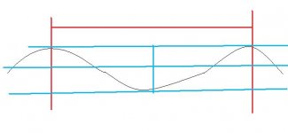

ok..since I have never even contemplated learning this, I am assuming a couple of things
1. freq is red, wave height is blue.
2. pi is in the equation because if you count the arc from crest-midline-trough-midline-crest you have 360 degrees of total arc. is wave length the length of the surface (if you stretched the wave out length wise and measured it?
if this is the case, by calculating the circmfrance of the circle created by the wave would give you wave length....
