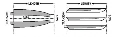

    One of the SVL issues. Rules are not the same org to org.
    SBI Rules
    6.3. BOAT SPECIFICATIONS:
    Super V Limited
    Hull Type: Monohull (Canopy Recommended)
    Length: 26’– 0” minimum to 32’-0” maximum
    Beam Maximum: 8’6”
    Number of Engines: One
    Weight Minimum: 4750 lbs.
    Engine Type: SBIP Super V Limited Specifications (See 6.8 Engine Specifications)
    OPA Rules
    Weights and Dimensions:
    Hull type: Monohull
    Length minimum 26' 0"
    Length maximum – Bow to Transom – 30’ 0”
    Length maximum Overall: 32' 0"
    Beam minimum: 6’ 6”
    Beam maximum: 8' 6"
    Number of engines: 1
    Single Step Hulls Weight minimum, Bravo, Imco drive 4750 lbs
    Multi Step Hulls Weight Minimum, Bravo, Imco drive 5500 lbs at first race – adjusted for parity by OPA.
    APBA Rules
    1. Hull Weights and Dimensions:
    Hull type: Monohull
    Length maximum overall: 32' 0"
    Length maximum bow to transom 30’-0”
    Beam minimum: 6’-6”
    Beam maximum: 8' 6"
    Weight minimum, Single Step Hulls 4750 lbs
    Weight minimum, Multi Step Hulls 5000 lbs**
    ** - Multi Step Hulls minimum weight shall be 5000 lbs at the first APBA Offshore race and then may
    be adjusted for parity by APBA Offshore at future races.
    My interpretations.
    I believe the current APBA rules are the rules followed by OSS and P1 SVS as the three of them are linked in events. But, there is a weight rule interpretation different for the P1 SVS based on horsepower.
    Within the rules are other differences also. Mostly power, but some width I believe.
    Here is the SBI measurement rule. I believe all orgs follow these measurement rules. The overall would include any bustle or platform extending past the maximum transom length as in the pic.

    Paul they do not count the bussell in the length ,,it,s from the bow to the transom,,
    too many boats have dive / deck / bussells on the decks..
    #31
    37,553
    Quote Originally Posted by imco offshore View Post
    On the OPA new rules they have bow to transom and overall. I was thinking the overall included the bustle or other protusions like a swim platform.
    #32
    Apr 2009
    2,286
    yes ,,but the delima is the hull has a 30' length limit,,overall is 32,,,no matter what, we still need a new 30' hull ,,
    #33
    37,553
    We're on the same page there.

    Did you look at how the hulls are measured in the pic above? Is that the way your hull measures 33'10"?
