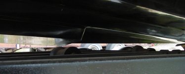

    Here is a shot of the very first prototype bottom....It's the clearest I have....but had no external airtraps (added later).
    The second shot is my hull which is not as clear...but is so dark because of the air traps which act like a skirt from the front to the back steps.
    The last shot is Jim Mertens running at Parker, AZ (I think) with a wing and you can just see the forward sponson steps peeking out from the bottom.
    Unlike most hydros (and some of the Conquest Cats we built), the wings have skirts on the outside of the sponsons rather than on the inner edges of the tunnel.
