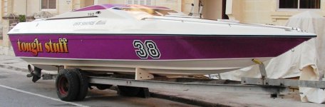

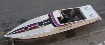

    I am an enthusiast with little experience in powerboats and at present, I am considering the purchase of a Carrera Powerboat (pics attached).
    First of all I haven't found much info on the Carrera Brand of hull in particular this one. The actual model name is completely beyond me! It does however look similar to that of the Carrera Cartier 27' with Bathing platform (pic also attached)
    The powerplant consists of a single 454 Mercruiser Magnum with Bravo 1 Drive.
    The hull and powerplant look to be in good condition and I am looking for advice on what the pros and cons are of this model and in particular what gremlins may be laying in wait!!!!!
    Your help is much appreciated
    Attached Thumbnails Attached Thumbnails IMG_1187.jpg   IMG_1188.JPG   IMG_1189.jpg

    It almost goes without saying, but--- get a survey. Any soft spots in the transom, stringers, etc.? Test driving will reveal much (not all) about powertrain. Ease of starting, idling, throttle response, ease of shifting, peak rpms, steering firmness/response. Survey should detail condition of systems and accessories, leaks, construction faults, etc. Notice it didn't have tabs; may not be necessary as I have no experience with Carerra. Good luck, keep us posted.

    WEll looking at the piks, it looks recently painted, the interior is a dark color, may get hot in the sun. I am suspecting the transom was recently redone. stringers?? By whome and did they know what they were doing?? What makes me suspicious is that there are no tabs and the X is insanely low on that. that will eat quite a bit of speed unless you put a shorty on it and then it still looks like it might be low. The drive and gimble dont look bad per say but there cosmetic appearance doesnt match the rest of the boat. The rear tie downs arent 'normal" for a boat and in the normal location. Im not trying to say anything bad about the boat, just saying have it checked carefully as a few things just don't look "right".

    Hop, the X dimension is the measurement between the the crankshaft (or drive input shaft) centerline and the bottom of the boat - in your case (a single engine) the bottom of the V. Phragle is saying that too big a number or too great a distance -putting the propshaft too low in the water can be somewhat mitigated by a shorty lower unit on your drive. Indeed, the transom seems to have been reworked as the tie-downs are not in the standard position. This not necessarily a bad thing but it's at least a pink flag to look deeper. Good luck. Jeff

    I don't think it is like either mentioned or pictured. The strakes appear different then the Cali brochure. And I seriously doubt the east coast on would have installed swivel helm seats or that steering wheel. I suggest you confirm the hull id matches and be certain it is not some knock off.

    I have to agree with the others, this boat just looks "strange".
    The X-dim is extremely low.
    The rear tie downs are out of place.
    The interior doesn't look like it even belongs in a boat.
    The trailer is "interesting" as well. I'd want a dual axle for a 26/7 boat. The four wheels on one axle is strange.
    Also, the trailer bunks look cobbled together and the trailer appears way too short.
    It appears the bunks stop a few feet short of the transom, which will cause some serious hook in the hull with the weight of the motor/drive not being supported.

    The hull IS a FAKE and not built by Carerra. A plug was made from another Carrera boat here in Malta so safe to say that I haven't bought it!!!
    @Buoy, the trailer axle is a full diff assembly from a Ford F150!!!!
    THanks again for all you help guys..... the hunt continues

    I am amused by numerous points. The square hatch round hatch thing, The numbers 38 on the hull side and a apparent model number on the cockpit side 790. Twin hatches for a single engine each with a V8 decal. Finally cabin cruiser cleat and chocks on the bow and nothing anywhere else.
    Best of all is the name tough stuff offshore with the cabin cruiser steering wheel and swivel seats. I can only imagine how ugly the engine compartment is.
    Best of Luck on your hunt. You now know everything you do not want in a boat. I think the deck came off an older Baja Force.
