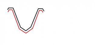

First, I know that it really really minor, but if the purpose of bagging and drawing the resin through is nice, even, consistent, saturation; wouldn't there be a better method than using the plastic shething? Wrinkles, folds and anything like that will leave a thicker spot, right?
Would final product thickness just pretty much be dependant on the fabric and mat now?
If perfection was the end goal...or if you wanted to be even more critical anyways...wouldn't an interior and exterior "mold" be best to help keep shape as desired. End up with a process close to injection molding except the gel and mat are in there prior to adding the inside shell. Kinda like the super detailed schematic attached
I realize that bagging must be a huge advancement beyond traditional hand applications, but .... ???
