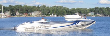

    Oaky, I guess I have to make a couple calls. Pics from a friend of testing out of Lake Macatawa Monday!!!!!! (Really small pocket camera)

    Mike you are right we where testing the race boat on 92oct fuel in the main tanks and BOOSTane in the system tank.The engines are set up 1350hp with 16lbs of boost.We ran the boat hard for 35min.My goal is to run a full race on regular 89 fuel.
    Mark and I are real close to releasing the product and the system.
    You might see a little more of Jaws next year.
