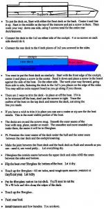

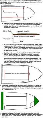

    Here you will find the type or design that I have used to build
    I want the versatility and weight of the foam if I sandwich it between glass on a boat
    Let me know what you think on it
