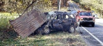

    http://www.mlive.com/news/grand-rapi...memade_tr.html
    COURTLAND TOWNSHIP -- A woman is dead after a homemade trailer hauled behind a van came unhinged on 10 Mile Road NE and flew through the windshield of an oncoming SUV.
    The crash occurred just before 9:30 a.m. as the van was traveling east on 10 Mile Road near Brower Lake Road. Police said the trailer-hauling mechanism fell apart and the makeshift trailer flew over the top of a vehicle following and into the windshield of the westbound Mercury SUV, instantly killing the female driver, believed to be in her 40s, according to Kent County Sheriff's Deputy Steve Dabkowski.
    A female passenger in the SUV was sent to Spectrum Health Butterworth Hospital with minor injuries, according to police. The van driver was not injured.
    Police have not identified those involved and 10 Mile Road remained close for more than three hours after the crash.
