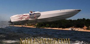

    I would say as your comming up to the wake aim at a 90' angle to the first wake and put the throttle on the dash and hold on real tight...
    Attached Thumbnails Attached Thumbnails gladidator 3.jpg   gladiator - Copy.jpg
    I would if I wasn't in my boat. I don't have any interest in getting my boat 5' out of the water like that.

    Jump them it's a blast once you get the hang of it. We have our friends go make us wakes just so we can jump like the pic above of bigyellowcat.
