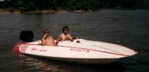

    George Linder's first race boat was a 1966 16' Carlson Challenger called (with some questionable originality ) "Challenger 1". He bought it after watching one of my old dual engine Glastrons at races..........We rigged it at K&K Outboard with twin 110 Merc inlines and speedmasters and it was a slug....no speed, bad turning and handling, terrible in rough water (it spit his co-driver out in the old Nyack Regatta on the Hudson River)..... but very pretty in Red Metalflake with real gold leaf lettering.... I called it George's "Skateboard". Art Carlson had told George that the hull design ( a cat in the front with an SK like flatbottom in the rear)would bank in turns and get around a short course quickly.....After the boat was completed we tested it repeatedly and none of us could get it to bank or turn quickly.... The boat's first race was the Orange Bowl 9 hour and, lo and behold, Art Carlson was there. George tells the story of asking Art to drive it and show him how to turn the thing. Carlson apparently begged off saying he had a head ache and never went near the boat for the remainder of the event.
    I tested it numerous times and found it to be slower than the Power cats I had driven previously......and no match for Glastron ( pre Carlson designed) or larger Eltro vee's. George kept it for a season and raced an 18 Eltro the following year ( Challenger II..... )..... Later George called his award winning 21 vee bottom design..... "Challenger". I wonder why..... George learned so much about how NOT to design a boat from the Carlson, that he wound up creating some of the most iconic hull designs in offshore history.......with a little help from his friends...
    The Carlson did have a wide flat bottom at the transom and probably would make a good ski boat...... in calm water.

    Yes the pic is George......... in late 1965, right after we finished rigging the Carlson.
    As to your other question..... I ran a couple of dual engine Glastrons, a 16 and a 17 footer. They were the hottest thing in the old JJ class from 1963 through 1966 or so ( We ( Ken Kalibat and I) were second in JJ class in the '66 Orange bowl Regatta (about 150 boats made the start in 5 classes)with the 17 footer.......and my 16 footer (below winning the Merrick Bay Regatta in 1965) won at least a half dozen races. The designs were changing quickly and i went to an Allison and then a couple of Eltro's in the next 2-3 years. At that point the tunnel revolution took over the OPC classes and I stepped into Molinari's, Seebold's...etc.
