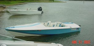

    Judging by the drive S/N it looks to be built late 72, early 73.. Is there a HIN on the registration? You can look under the deck lip stbd. side, my X is stamped there not on the transom...

    Very sweet. I wish Donzi used the same deck on all the Classics.
    LOL, I'm glad they don't
