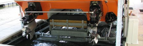

    I have a complete set of Bravo-1 ITS's that I took off my Nor-Tech if your interested in a used set...
    Attached Thumbnails Attached Thumbnails 15833_7.jpg   xr drives.jpg   drives rear.jpg
