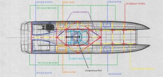

    The "crash" bulkheads go in next, the new cockpit liner is structural, so we will have a cockpit within a cockpit. There will be NO penetrations (or hatch access) through these bulkheads.

    Guy your layout looks great....BULLET PROOF!

    heatwave, you guys ever think of foam filling the voids created by the "deflector-bulkheads" ?

    How far aft was the canopy moved?
    #59
    Registered BradH's Avatar
    Atlanta/1000 Islands
    125
    Are you making the changes to the bottom?
    Do you have a weight and CG estimate Sean?
    #60
    The bottom is staying the same, the canopy is coming back about 30 inches (also going from 4 person to 2 person). The CG should stay around 105 but with a more focused weight around that CG with the elimination of the ext. boxes and moving the engines forward (they were moved rearward to test this CG placement).
