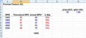

    Our 2006 292 came with labbed 28p Bravo 4-blades. The pic below shows the slip I see at various rpm's. This was during a 90°F day and calm water on the Mississippi River. The 'Actual MPH' listed is an average of going with and against the current. As you can see, the labbed props like to slip at the lower rpm. The SmartCraft pic is going with a slight current. The speed of the river current can vary a lot.
    Hey Bill, how's it going? I would hang on to those 26's! If you are going 52-54 mph at 3800 rpm that is 5-8% slip. Or is this including a little help from the old Miss current? Are you running the stock exhaust? Looks like she is running real good. We see right at 70-71mph max, but usually have a lot of stuff on board. Engines now have 189 hours.

    Yes, my cruise speeds are on the Miss. and I lose about 2-3 mph against a strong current. My WOT numbers are from Lake St. Claire with no current.
