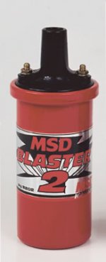

    I am making the switch to MSD since Crane is out of order for the time being.
    One thing I have noticed is that several high end engine builders out there who also use MSD seem to stay with the "old fashioned" oil filled coils (BLASTER 2).
    They are about 1/3rd the cost of the the dry cell (HVC) coils. I am wondering if anyone knows if there is an advantage to one or the other or is there no difference thus, stick with what you know?
    I called the MSD tech line and the person on the other end essentially wanted to convey that the dry cell is better because it is more expensive. period.
    The oil filled has 45,000 volts vs 42,000 for the HVC BTW.

    The buzz I've heard is that the dry one's are more reliable. I don't go through too many coils so I can't say they're chasing a dire need with the product.
    The Blaster has worked fine for me for many years.
    Same here!
    As far as the new style coil goes; I saw one fail on my buddies Velocity two years ago so I'm not completely sold on them.... The whole system was brand new, even had Teague's fancy shmacy bracket to told it all in place, and between a carb/fuel problem and the coil it drove us crazy because they were producing similar symptoms!
    I have the blasters on the Apache and never had one fail since 2005 but I do keep a spare coil/box on the boat just in case. Had a box go bad once....

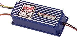

    Are you guys using the MSD 6 ignitions too?
    Not me, just a Thunderbolt IV on all three engines.
    37,354
    Quote Originally Posted by 2112 View Post
    I have MSD on three engines and Merc on two engines. No issues other than a master box failure on an MSD ignition on the one boat.
    6M with softouch and MSD dist for me.
