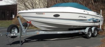

Great job Jeff!!I'm doing it over the winter also.I have ducts on the boat from the factory that are not connected to anything but an air box in the gunnels.Here's a pic. the sir box inside has 2 4"openings on each side already.I'm going to use pvc pipe.I let you know if it slows me down.
Mine is a ramjet setup so the duct work will ride along the rear bulkhead.
